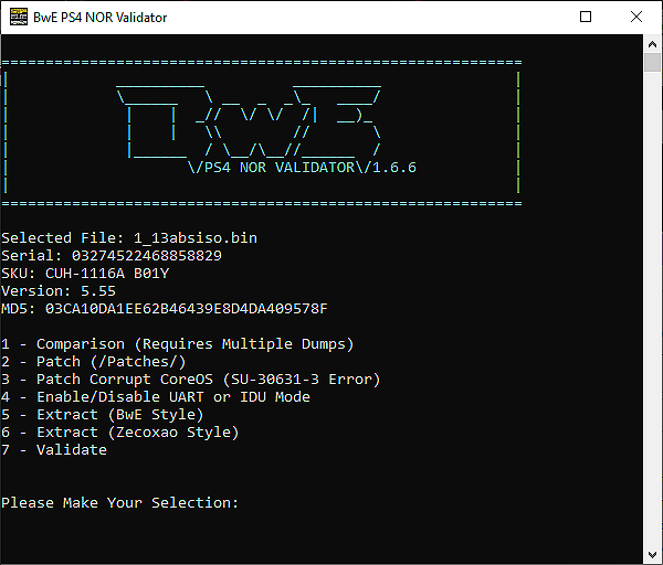

Menu Options:
1 - Comparison
Launches the comparison app, used for the bulk diagnosis and comparison of dumps (Put multiple .bin files in the same directory). Features multiple output options.
1. Compare Offsets
2. Compare Offsets MD5
3. Compare Offsets Entropy
4. Double Offset Comparison
5. Dynamic MD5 Calculation
6. Compare File MD5
7. Compare File Entropy & Byte Count
2 - Patch (/Patches/)
Designed to load .bin patches from the /patches/ directory. It will interpret and auto locate patch offsets if they've been extracted by my program. If not it will ask for a start address.
3 - Patch Corrupt CoreOS (SU-30631-3 Error)
Basically an automated version of what Andrew Paul suggests. It will scan the CoreOS and patch the corrupt sections within about 1 second.
For some strange reason, if your ps4 core os gets corrupted, and displays the error SU-30631-3, you can "fix" it by just patching the region with random garbage, and then attempting to update. this means that the coreos isn't hashed in snvs.
3 - Enable/Disable UART or IDU Mode
Enabling/Disabling the UART flag within the PS4 - Will work without the need to jailbreak. If this does not work check the UNK UART Flag status and email me!
4 - Extract (BwE Style)
Extract based on literal files and does so dynamically based on their size
5 - Extract (Zecoxao Style)
Extracting file sections pursuant to Sony's file blocks
6 - Validate
Pretty obvious, will scan the entire dump from start to finish and produce a readable validation output in HTML format

So I have this PS4 Slim that it's stucked in recovery and gave me error SU-41283-8. I've taken a dump if the NOR for fizingf WiFi/BT nut it gave me this UNLISTED and 0 warnings:
SLB2_2 Dynamic Section 2 (File Size): 4C820 [UNLISTED]
C0000001_stage2.bin MD5: 2B0DCD03621CA9306450437D08FDDA79 [UNLISTED]
C0010001.bin MD5: AE86D15F60DB6AFF89B211BC9D574346 [UNLISTED]
CID SKU Ident 29 (Slim Pro/Special): FFFFFFFFFFFFFFFFFFFFFFFFFFFFFFFF [UNLISTED
CID SKU Ident 30 (Slim Pro/Special): 010000001080500311BF6B5701005103 [UNLISTED]
Am I good to go? @BwE
Sorry I missed this three warnings:
CID Dynamic Section 8: FFFFFFFFFFFFFFFFFFFFFFFFFFFFFFFFFFFFFFFFFFFFFFFF [WARNING]
UNK Flag Filler 5: '01' found at offset: 0x1CD603 [WARNING]
UNK Dynamic Section 27: FFFFFFFFFFFFFFFFFFFFFFFFFFFFFFFFFFFFFFFFFFFFFFFF [WARNING]
Hmmm! I guess I will try something else to solve this issue for you guys. Would help if I could send beta versions to you guys immediately to test things. But oh well.
As for the unlisted message that's all good. If it's corrupt it won't say unlisted.
CID and UNK sections can sometimes come up blank. No idea why but it seems normal hence only a warning. If you had heaps that had the error then you can worry.
CID SKU Ident 29 coming up blank is weird. It can be patched though.
If it can help, you can count on me for testing new version. But I have only this PS4 with this problem. However with the new version 1.4.6 it gave me this
CID SKU Ident 29 (Slim Pro/Special): FFFFFFFFFFFFFFFFFFFFFFFFFFFFFFFF [UNLISTED]
@sautzer
Should be fine. The slim pro special thing can be patched. It's not common for it to be blank. Might be a problem. Might not. It's a mystery!
