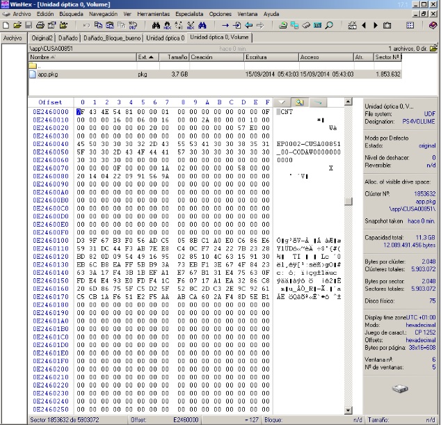

In this case the reader acts independently. At least the first stage Reader recognition it is not necessary to initialize the board. But my surprise is that the contents of the games shows them. But wait ... I have the reader off the console! ...
Up to here safety with the naked eye. I do not know if he will do later Checks when playing or playing. I lack research on safety applied afterwards. Also if it is ethical or not about my principles in backups ...

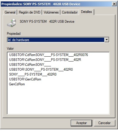

I leave a few captures of what you will find once the reader is connected to the PC. I used a converter circuit from SATA III to USB for convenience (longer cable).
Capture under windows of properties ...
