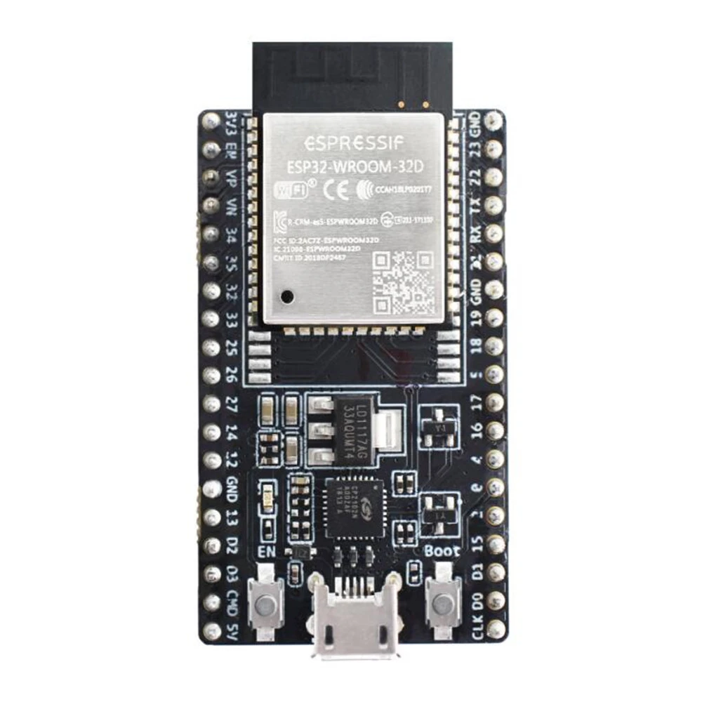

This is a project designed for the ESP32-S2 and ESP32 boards to provide a wifi http server, dns server and *USB storage emulation. It is for the PS4 9.00 OOB Exploit.
⚠️ If your board is an ESP32 the USB emulation will not be available so you will need to wire a USB drive up to it like this project PS4-Server-900u or you can manually plug and unplug a USB drive for exfathax. This is a wiring diagram for the ESP32 boards.
:thumbup: If your board is an ESP32-S2 you do not need a USB drive with this project as it emulates a USB mass storage device to the console and triggers a filesystem bug to leverage the exploit (exfathax).
These ESP32-S2 boards can be used for a plug and play setup (no wiring):

These ESP32-S2 boards will need a usb A plug wired up to them:
4MB boards

Installation is simple you just use the arduino ide to flash the sketch/firmware to the esp32 board.
Next you connect to the wifi access point with a pc/laptop, PS4_WEB_AP is the default SSID and password is the default password.
Then use a webbrowser and goto http://10.1.1.1/admin.html 10.1.1.1 is the default webserver ip or http://ps4.local
On the side menu of the admin page select File Uploader and then click Select Files and locate the data folder inside the ESP32_Server_900 folder in this repo and select all the files inside the data folder and click Upload Files you can then goto Config Editor and change the password for the wifi ap.
Alternatively if you install this plugin to the arduino ide you can upload the files to the esp32-s2 with the arduino ide by selecting Tools > ESP32 Sketch Data Upload
