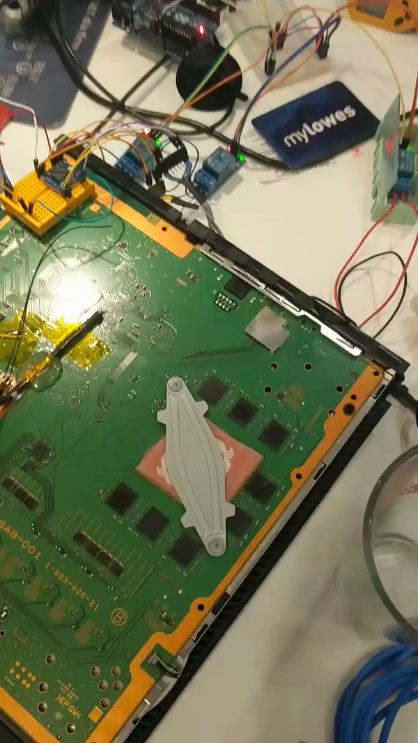

Recently Volodymyr Pikhur has been working on a PS4 IPL AES + HMAC Key Recovery Project with help from nedos utilizing a Verilog FPGA (Field-Programmable Gate Array) to detect IPL (Initial Program Load) read and trigger capture board.
PlayStation 4 hardware guys that favor FPGA's including @Chaos Kid will definitely take interest in this project, and here's to hoping we see some more on it in the future!
