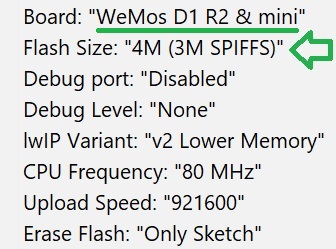

Make sure you set the flash size to match the D1 board you are using.
4M (3M SPIFFS) for the D1 Mini
There is a storage limitation of 2.8mb for the D1 Mini board.

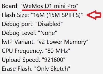

16M (15M SPIFFS) for the D1 Mini PRO
There is a storage limitation of 14.2mb for the D1 Mini PRO board.

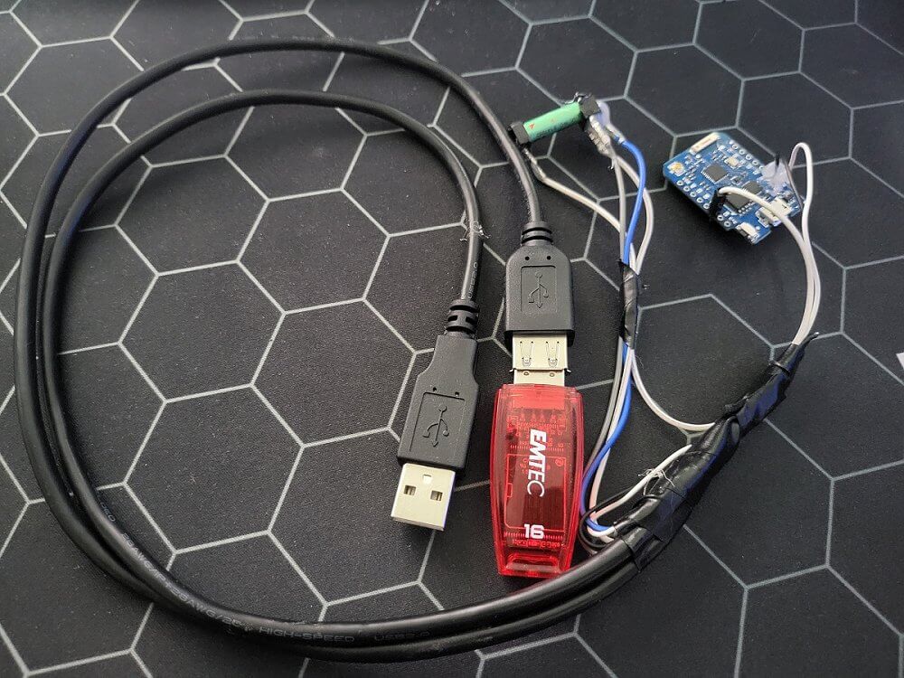

Fast and dirty, this is the test cable I made and this would be the easiest for people to make.
Parts used are:

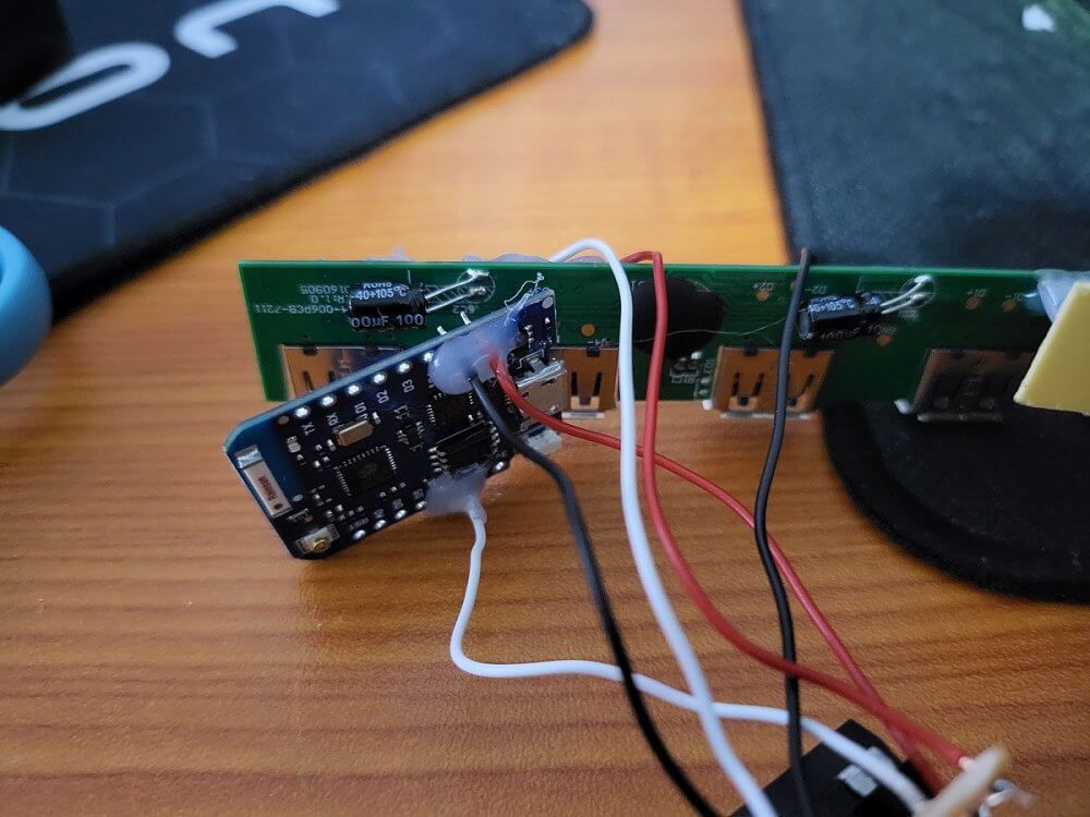

This is the mod I did and the parts used are:
  • D1 Mini Pro v1 ESP8266 board.

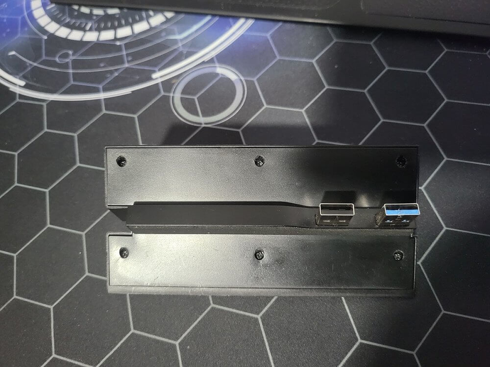

  • PS4 USB HUB TP4-810
  • TRR1A05D00 5 Volt SPST DIL Reed Relay.
  • SanDisk Ultra Fit 8gb usb drive
Some pictures of the mod:
PS4 Server 9.00 PS4 Server 9.00u for ESP8266 D1 Mini & Pro by Stooged 10.jpg
PS4 Server 9.00 PS4 Server 9.00u for ESP8266 D1 Mini & Pro by Stooged 11.jpg
PS4 Server 9.00 PS4 Server 9.00u for ESP8266 D1 Mini & Pro by Stooged 12.jpg
PS4 Server 9.00 PS4 Server 9.00u for ESP8266 D1 Mini & Pro by Stooged 13.jpg
The end result:
PS4 Server 9.00 PS4 Server 9.00u for ESP8266 D1 Mini & Pro by Stooged 14.jpg
PS4 Server 9.00 PS4 Server 9.00u for ESP8266 D1 Mini & Pro by Stooged 15.jpg
