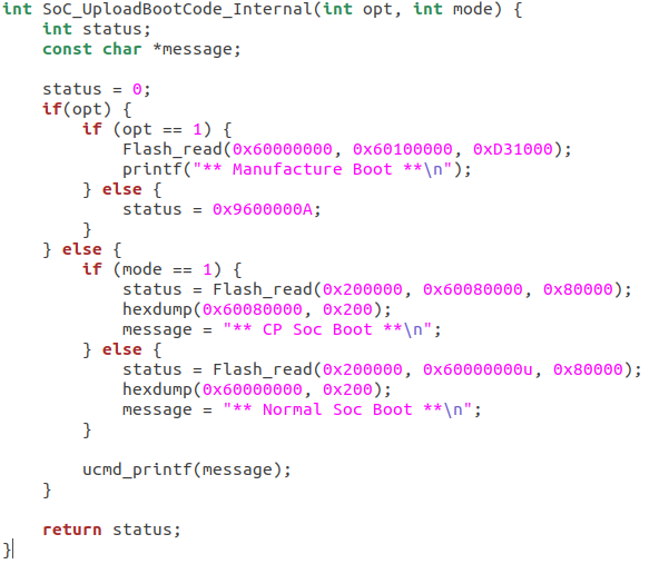

He states, to quote: "Here is some reversed code from the southbridge... this is where the data is read from the flash and sent over PCIe. This is the perfect place to modify the southbridge to change data for a correlation power analysis attack against the APU bootrom loading the second bootloader."

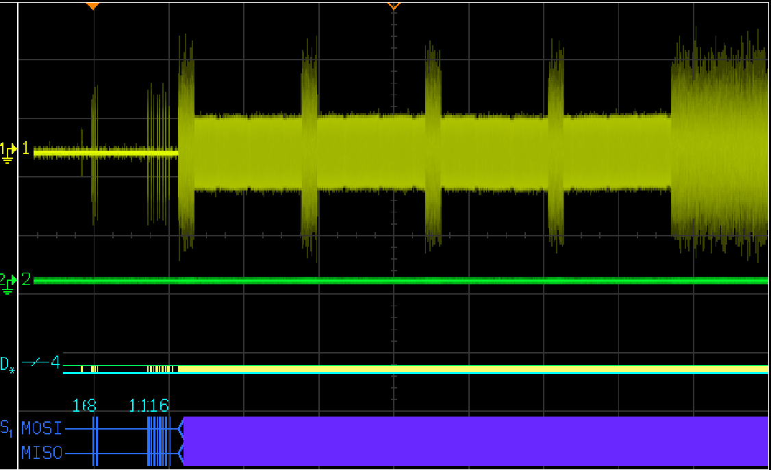

Picture of the PlayStation 4 APU bootrom reading the second bootloader over PCIe, this is read from the system flash using SPI via the southbridge. The low spots are where the data is all 0xFF, where hamming distance between data lines/registers stays constant.

Here is a better image of what is going on when the PlayStation 4 APU turns on. The southbridge reads the second bootloader from flash then sends it over PCIe to the APU bootrom, which decrypts and loads it. I deleted my old post because of some inaccuracies I discovered.
Also in the image, yellow is power consumption, green is APU reset, and the pink/mosi/miso is data on the SPI system flash lines.
