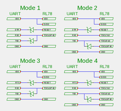

2. Correct way to program the hypervisor to create the glitch (sysconf)
forma correcta de programar hypervisor.pdf

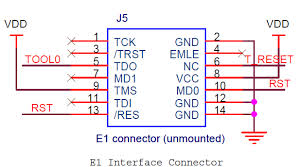

ups sysconf conexión pinout
https://drive.google.com/open?id=0B2cZly5GV8y-QUhkaEdhT1hPS2s
ups conexión programador
https://drive.google.com/open?id=0B2cZly5GV8y-VlJhbnBYeDV2VWs
ups alternativa alambre de conexión 1, 2 hilos thanks marcan slide
https://drive.google.com/open?id=0B2cZly5GV8y-aFJDUUYyUWxBNTA

Ups sysconf connection pinout
Https://drive.google.com/open?id=0B2cZly5GV8y-QUhkaEdhT1hPS2s
Ups programmer connection
Https://drive.google.com/open?id=0B2cZly5GV8y-VlJhbnBYeDV2VWs
Ups alternative wire connection 1, 2 threads thanks marcan slide
Https://drive.google.com/open?id=0B2cZly5GV8y-aFJDUUYyUWxBNTA
